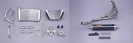

Gick nog att köpa bara vissa bitar från kitet så att den har HRC-Kit betyder kanske inte att den har hela kitet. Kamaxlar, ventilfjädrar, växellådsdrev och tändbox var väl dom grejerna som sattes i bl.a. Öhlins ingick inte i det kitet. Ska väl ha 108-112bhk med kitet?
"Well-Known "Super Sports Race"
This kit is used to upgrade a machine to the race potential of the CBR600F, which was substantially changed this year. This kit has a much greater and effective power band than that of the standard model and therefore has increased power. Following the increase in the number of rpms of the engine, the dynamic valve system and the transmission have also been strengthened.
[Racing Kit Lines]
•Engine power-up kit •Transmission kit •Coolant hose plug kit •Oil cooler kit •Tachometer kit •Steering damper kit and •Large-capacity radiator
